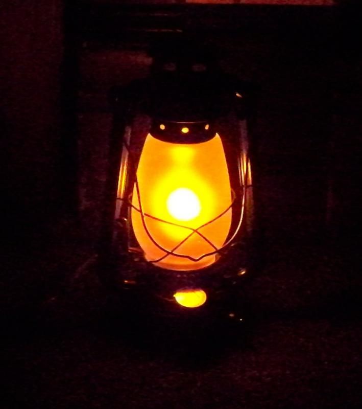

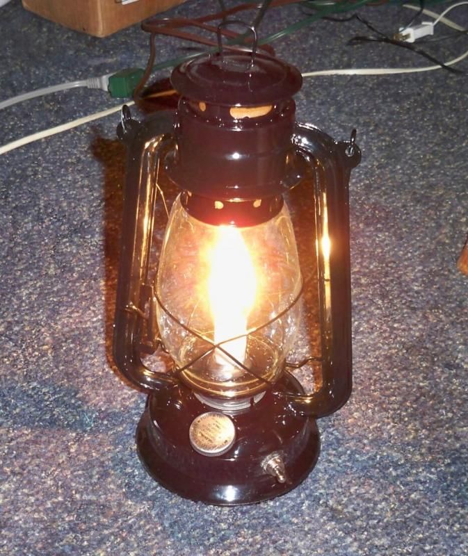

I'm certainly no electrician by any stretch of the imagination. But I know enough about the work involved to make a lamp or two. And that's pretty much what I did. And it's a lot more fun than some might think.

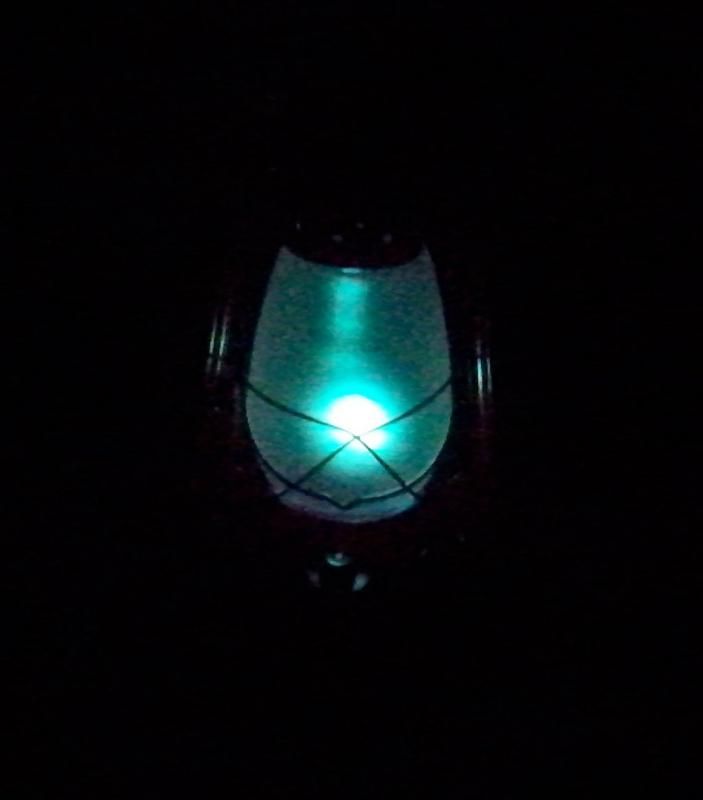

At the moment, with the frosted globes, and the Christmas bulbs, they're more decorative than anything. But I had enough brains to use sockets rated for 75 watt bulbs, so that can be changed if desired. But I can't do much about the globes.

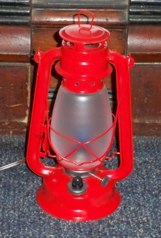

Since the black lantern was the prototype of the two, the work is rougher than I'd like. But there's not much I can do about that. By the time the red lantern came around, I knew what I was doing, and what I wanted to do, so it was a lot easier.
The frosted glass provides greater flexibility since the colored bulb can easily be swapped out for something different. Unfortunately lighting isn't properly uniform, meaning I either need something stronger than a 7 watt Christmas bulb, or I need to paint the globe a single color, put a full 60 watt bulb in, and see if it can still light it up to a desirable degree.
